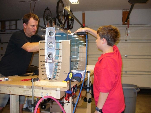

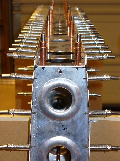

Brief Description: Cleco right HS, match drill, take apart
Larry K would be having a blast doing this! Assemble right HS, match drill to #40 size (3/32 inch,as all skin holes), then disassemble the whole affair. Next time, deburr all holes, then dimple (countersink for thicker spars) skin and ribs, start final assembly.Couple notes - nose ribs needed a little fluting of the front web to pinch the nose in a bit to fit the skin better.Again, proving the flawless CNC punching of holes at the factory is the perfect alignment when all pieces were assembled.
assembly of right HS
preeettty. Missing are brackets on the rear spar for the elevator.
