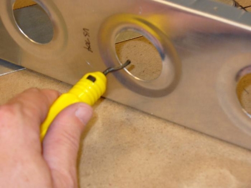

Brief Description:  More tools - deburring
A few tools used for de-burring. Briefly, de-burring must be done on every machined edge, hole drilled, etc. to remove any cuttin gtool created burr. The purpose is to ensure good seating of material, cosmetic result, and most importantly, to prevent stress cracks from developing.
edge deburring tool
edge deburring tool
Quick work with this one for lightening holes
Also can use a die grinder with scotchbrite wheel
