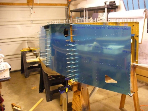

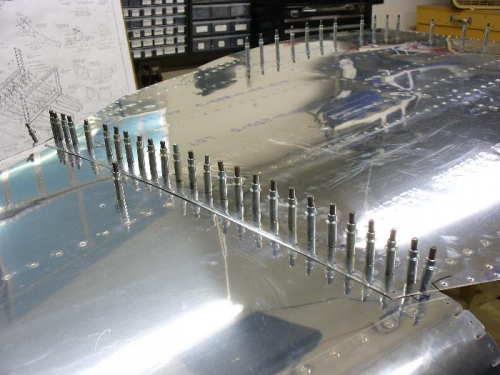

Brief Description: Attached aft to center fuse, added one F-970 side
Aft fuse set on sawhorse, same with center fuse - slowly attached the two with clecoes at the bottom skins and baggage ribs to F-906. Next attached side skins. Took a bit to get the alignement correct - helped to work from inside with the baggage skins off whilst jockeying the center fuse at the F-905 up and down a little to align holes
