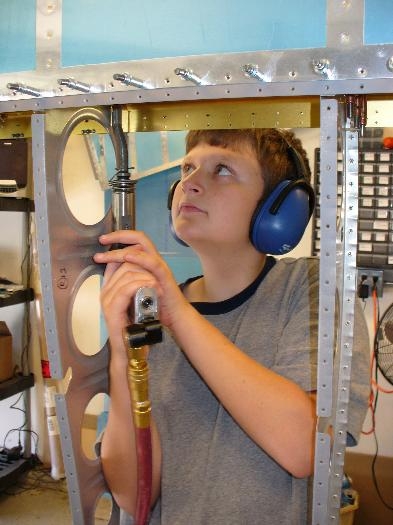

Brief Description:  Attached leading edge and tank
Attached leading edge, riveted all ribs with Austin's help, then skin to spar. Tank was installed, all bracket to spar bolts done and torqued (40 inch/lbs = 25 plus 15 drag), then the skin was screwed on (the tank has removable fastners so it can be removed even when the plane is done for repair purposes).
Offset riveting leading edge ribs to spar
