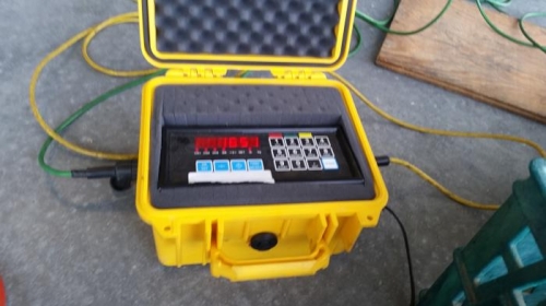

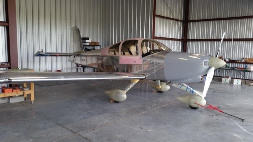

Weight and Balance was this morning. Kent Felkins came up from Tulsa to weigh the plane. It came in at 1650 lbs with a CG of 106.2.
This CG will be slightly inconvenient for solo flight, as I'll need to put some ballast in the baggage compartment. However, this FWD CG really makes it easy to stay within the Aft CG limits.
Kent also dynamically balanced the prop for me. It started at 0.3 ips, and we got it to 0.06 ips.
