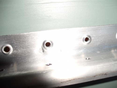

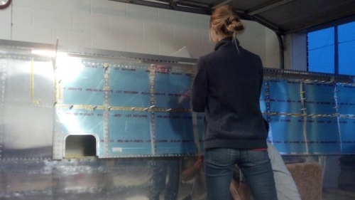

Tessa finally was available to help me for a few days to rivet the lower skins. They were a lot of work and overall everything went well. I did have two bad bar mark conditions. One was on the stringer, and the other was on an outboard rib flange. The pictures shown bellow show the bar mark, and the repair angle I nested over the discrepant location.
