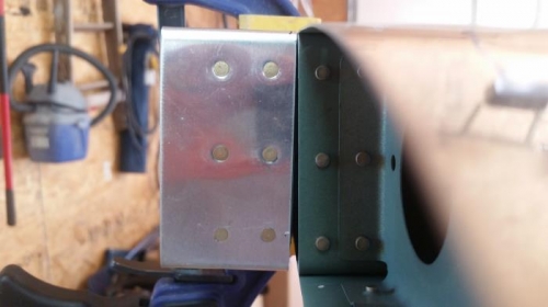

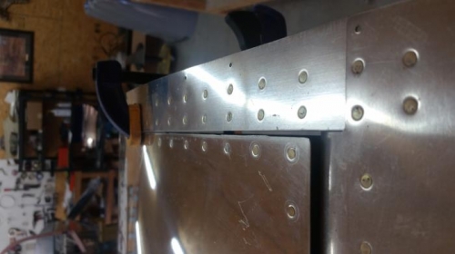

Brief Description:  Elevator counter balance rework
The final piece that I wanted to redo was the RH elevator counterbalance arm. The previous builder failed to adequately flute the ribs to allow it to be straight. There were a few rivet locations that had to go up to 1097AD-4 rivets.
