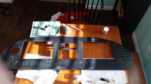

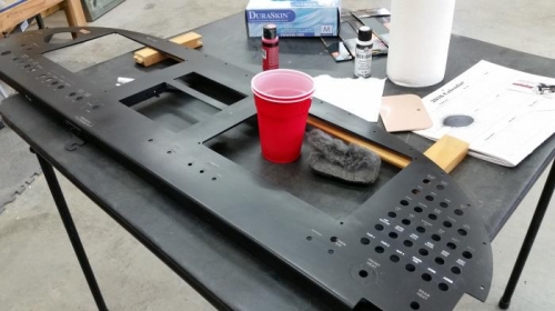

It turns out I didn't take any pictures while at the Laser engraver/Powder coating guy's shop. This was a very difficult process. The laser wasn't large enough to fit the entire panel, the drawing I had was not scaled correctly, and just getting the labels positioned perfectly was quite a task.
I ended up spending about 15 hours at the laser shop before it was all finished.
These pictures were taken when I got it home and started to brush on the acrylic paint. I would let it dry over the labels for about an hour, then I would wet sand. The labels would then crisp up and be very nice looking. Finally I clear coated the panel to help protect the label paint.
