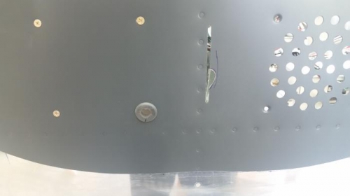

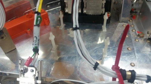

Brief Description:  Misc. panel installations
Doing some last minute installs such as the elt buzzer and FLYLEDs plastic standoffs for their control board. Also radius trimmed the center post slot so that the gps coax and dome light wires can pass-thru. Added the grommet for backup GDU gps antennas.Things that are just a little easier to do prior to installing the panel structure on the plane.
