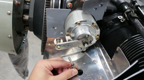

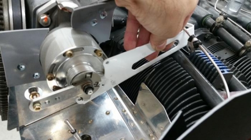

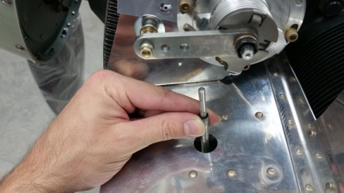

Brief Description:  Prop Cable problem
I ran into a little issue with the prop gov cable pass-thru hole. The plans have you drill the pass-thu hole before this baffle is fully built. I thought I had it good, but when it was completed and fit to the cowl, my hole was off. I considered running the cable over the engine as shown in the third picture, but in the end, I decided to slightly slot the hole . with the grommet installed, it isn't visible, and no air will leak through it.
