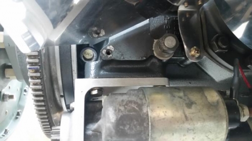

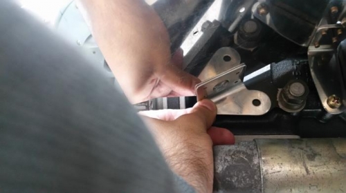

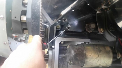

Baffle work
These pictures show an issue I had where the pictured support angle did not match the threaded hole in the engine. This must be a difference between the D4A5 and C4B5 engines. I fabbed my own angle from same thickness aluminum.
