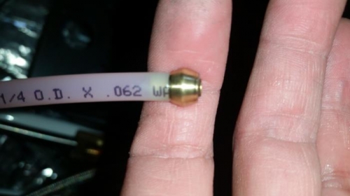

Time to bleed the brakes. I used the "one man brake bleeder" pump and it worked really well, and fast.
After I was finished, I noticed that one of my nylon tubes, looked odd. Upon closser examination I could see the brass sleeve extending past the nut. This didn't look right, so I had to disassemble this fitting. Ordered some new parts and everything went better the second time.
