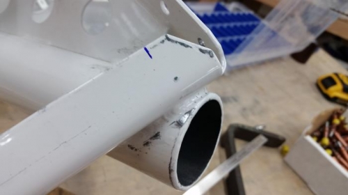

Brief Description:  Landing gear tower

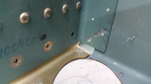

I became very frustrated in fitting the LH gear tower. With many points of contact, it was difficult to trace down an interfering section of it. I eventually discovered the root problem was the flange shown in picture 2. It was rubbing to the right of the sharpie mark against the fuse structure shown in picture 3. No fastener goes in this imediate location. Van's approved that I use a large hammer to encourage the flange not to rub anymore.
