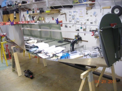

Installed upper engine mounts & longerons. Didn't have the edge distance for the 3/8 bolt on the upper right mount so I took it to Just Aircraft and they welded some 4130 to it then I shaped it to fit.
Check angle on the firewall and leveld the longerons fore, aft, left & right.

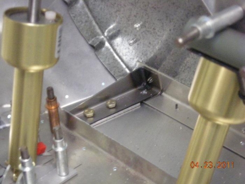

Plans call for shims under the lower mounts between the firewall flange and the pedal channel. This would have only one bolt going through the shims so I added an extra bolt to each lower engine mount. There was plenty of material for this to still have lots of distance between the bolt holes.
Upper right engine mount

Longerons & firewall set
