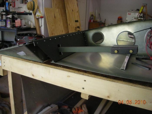

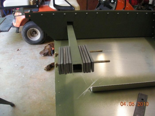

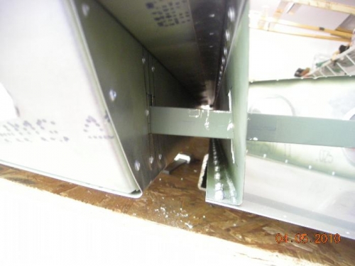

Date:  4-3-2010
Number of Hours:  3.00
Brief Description:  Aileron Upgrade & balance
Drilled out rivets and initial fit of gussets. Drilled first balance rib. Cut rear channel to accept balance arm. Installed protection plates on top & bottom skin. Also added 2 L angles on the front side of the rear channel to give support to the weight of the balance arm.
