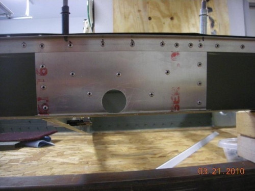

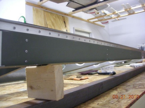

Brief Description:  Rear channel, Root & Aileron Doubler.
This was also pretty easy. The only glitch was that since my wings were not already built, the aileron stop had not been installed so I did not realize that it should be mounted on the back side of the aileron doubler until after I had already attached the doubler. I had to shift my aileron stop a little to the left (inboard) so as to not interfere with the rivets already in the doubler.
Root & Channel Doubler

Rear Channel Doubler Full Length
