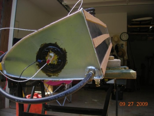

Date:  9-26-2009
Number of Hours:  1.50
Brief Description:  Tested right fuel tank for leaks.
Put gasoline into fuel tank and check for leaks at finger screen, sump drain & most importantly the fuel level sending unit. No signs of any leaks after 5 hours of sitting in the back yard in the sun. That pro seal is messy but I'm glad I used it. I also used allen head srews for the sender unit instead of the supplied phillips head screws.
