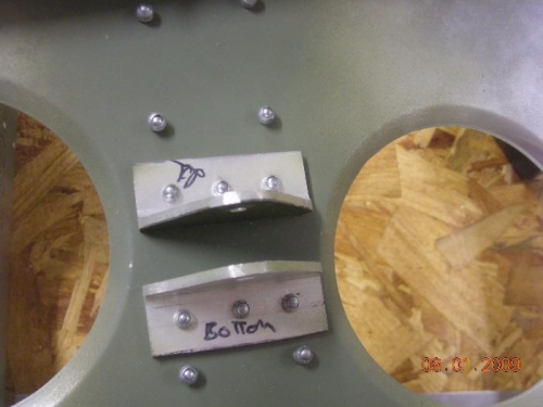

Brief Description:  Right Aileron Bellcrank.
Cutout Bellsrank support with bandsaw and sanded with belt sander. Cut the support channel to fit the rib then drilled, deburred, painted and riveted to rib. Checked the bellcrank for fit.
RIght Aileron Bellcrank Support

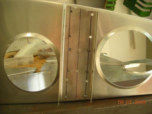

Bellcrank Support Channel on the opposite side of rib.

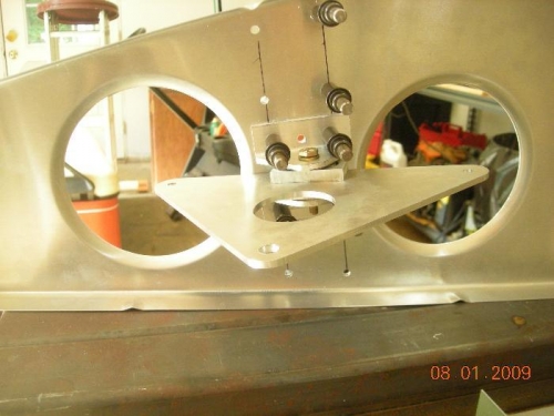

Bellcrank checked for fit.
