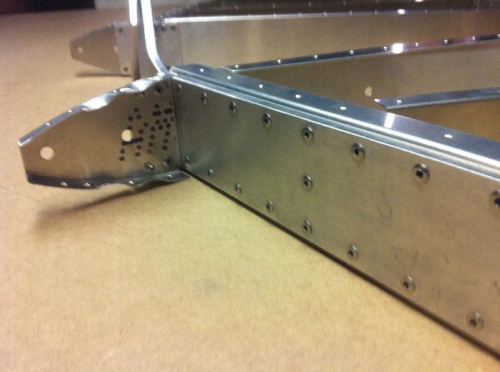

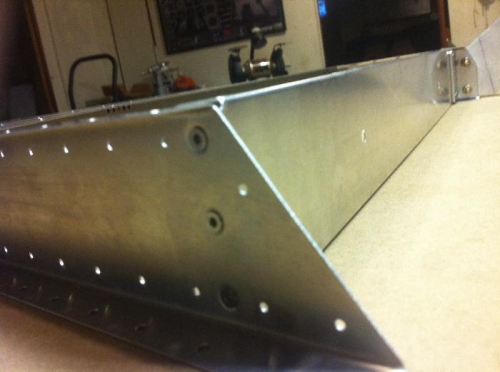

Brief Description:  LH Stabilator Rivet and Skin Fit
Fit skin to LH stabilator and final drilled with #30 drill bit. Deburred holes.
Riveted LH Stabilator sub-structure per drawing.
Flush Rivet Detail
Flush Rivet Detail
Standard Rivet Detail

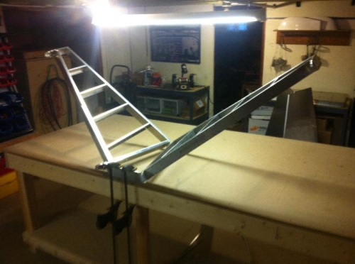

Stabilator Structures Complete
