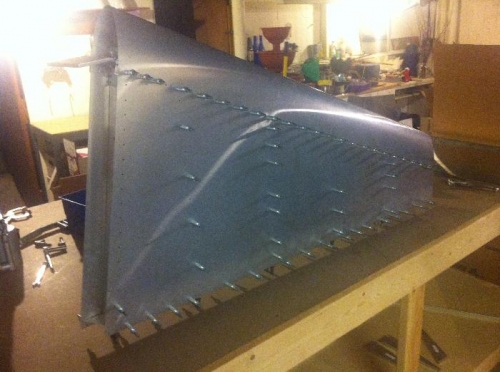

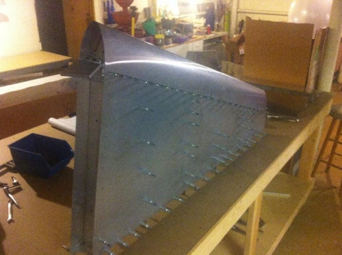

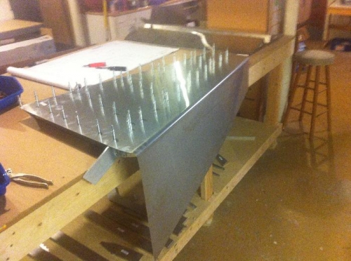

Fit skin to RH stabilator sub-structure with laser drilled pilot holes. Final drilled holes with #30 drill bit and deburred all holes after RH stabilator was fulled disassembled.
