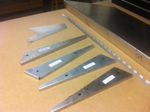

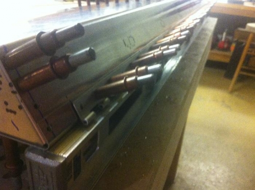

Aligned LH Ruddervator hinge 0.057" below top plane per drawing. Piloted drilled with #40 drill bit then final drilled with #30 drill bit. Disassembled ruddervator and begun to deburr holes.
