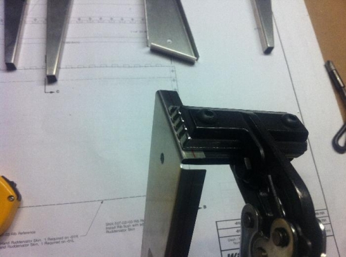

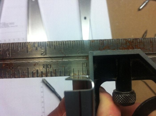

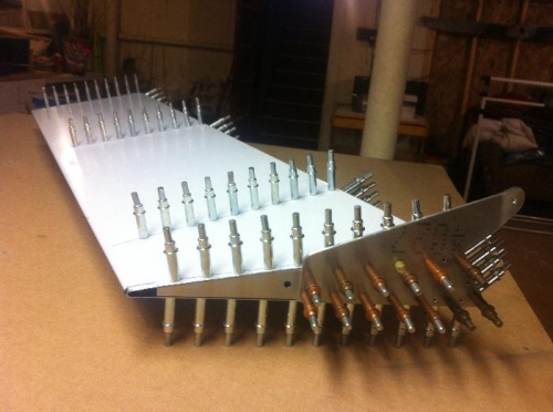

Aligned ribs and fully drilled RH ruddervator skin using #40 pilot drill bit. Rib flanges straightened with the end of seamer plyers. Hole spacing set with rivet spacing tool. Cleco's RH ruddervator assembly and confirmed parts fit together.
Rib flanges need straightening
Seamer used to straighten flanges
Ruddervator fully drilled
