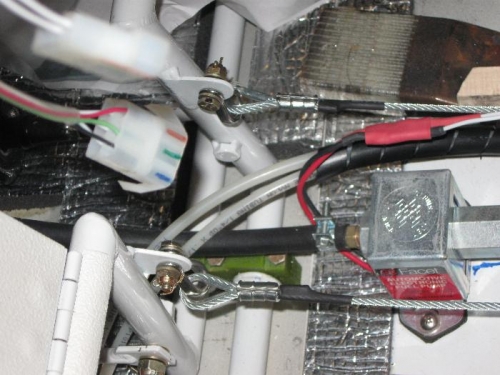

Swaged one end of the elevator and rudder control cables, cut then longer than needed.
Fitted the finished ends of the cables in the hard to reach places in the center console and rudder pedals.
Reinstalled the center console
Swaged with my brand X swaging tool from a tool supply shop & fits tthe go gauge with a few thou gap

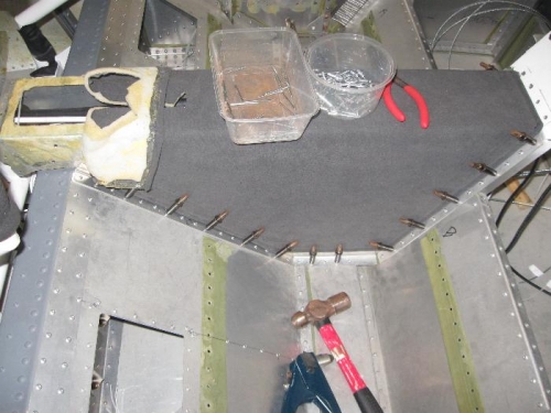

Upholstery had to be pulled back to release the saddles holding wires and tubes to the side walls
Rudder cables in place
