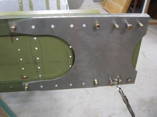

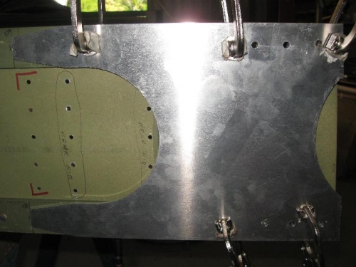

R/H root doubler
Installed the root doubler to the main spar using my drill guides.
It is crutial to fit the doubler to the spar mount bolts first to enable the doubler to be adjustment
Once the main bolt holes have been adjusted, the remaining 12 fixing bolts can drilled through
