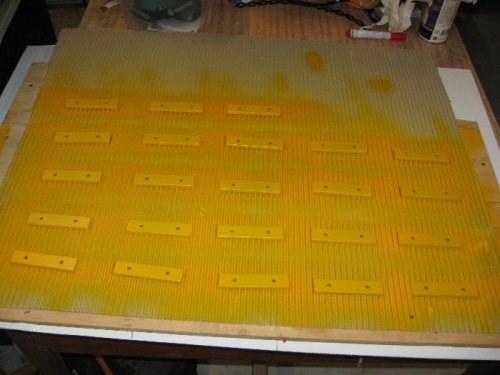

Brief Description:  mass balance
Cut 90mm long mass balance weights from 20x6mm flat bar steel. Drilled 3/16 hole 20mm in from each end.
Painted the weights with yellow Cold Gal spray paint.
Deburred and corrosion proofed mass balance ribs and arm.
Drilled one weight as a master and clamped two more at a time to it and back drilled them
