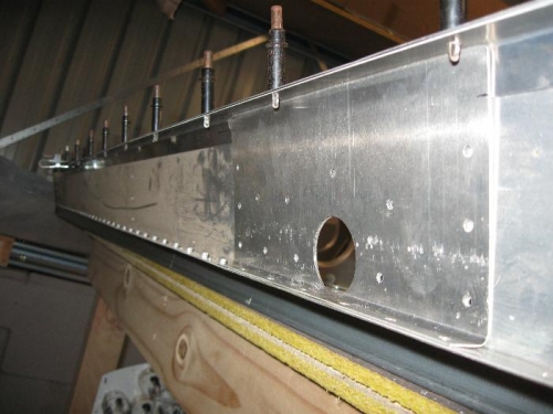

Started to backdrill the .040" rear spar doubler angles to the rear spar channel.

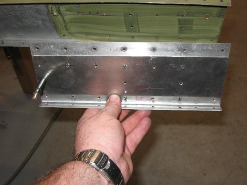

Prefitted the aileron pushrod hole and the root doubler to the rear spar. Debured the doubler plates.
I fitted the aileron pushrod hole doubler on the outside of the .040
I fitted the aileron pushrod hole doubler on the outside of the .040" angles
.040
.040" rear spar root doubler
