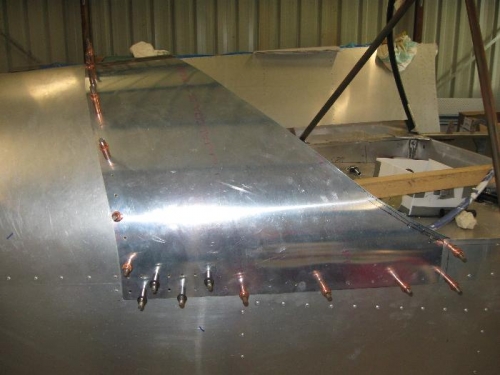

Brief Description:  rear flashings
Marked out and trimmed the edges of the rear flashing with my Olfa knife by way of cutting a template with the snips from scap 016 and then cleco to the flashing on a flat surface. This process doesn't take long and ensures that there are no unsightly ripples in the edge that snips leave. A spot of deburing and then I riveted it on.
trimmed and clecoed
trimmed and clecoed

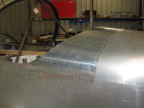

finish riveted L/H
finish riveted L/H

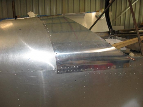

R/H
R/H
