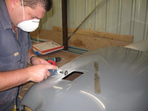

I installed the cowl hatch with 3/32 counter sunk rivets setting them just below the surface of the door. I may look into sourcing a fine gasketing material for under this door and around the cowls to protect the paint.
trimming access hole to width of hinge

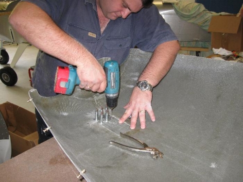

back drilling through hinge

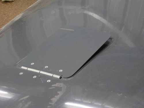

the finished product minus the fastener which has yet to be decided upon
