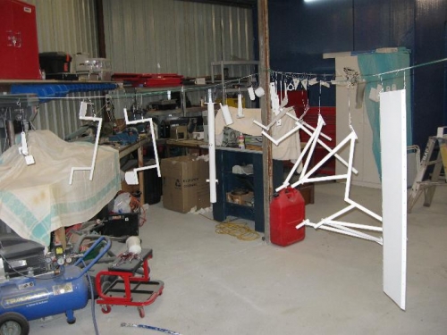

Primer and paint went on today with a great deal of ease. Painting all of the little parts took a fair bit of paint because there is a lot of wasted overspray.
The paint I used is a Protec 2 pack system as follows,
472 self etching epoxy primer surfacer which has just the right amount build to it. You spray it on wet and 30 mins later, topcoat without sanding.
609 colourcoat topcoat. Two medium wet coats 10 mins apart and the job is done.

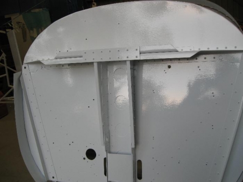

firewall looking spiffo

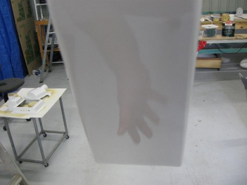

check out that gloss on the main gear !!
