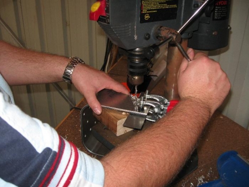

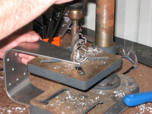

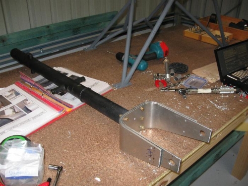

Drilled and assembled the front fork and doubler and the fairing brackets to the front strut. I took my time as I didn't want any elongated holes.
3/4 " axel hole was drilled in several stages starting with a 3/16" drill
Drilling the fairing bracket to the doubler first before everything was clamped together and through d
The front strut and fork assembled
