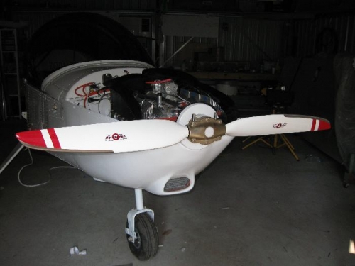

pitch setting

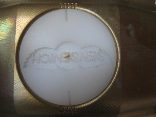

Removed the spinner and repitched the prop using my inclinometer to fine tune the blades to eachother.
levelled the prop before confirming both blades to be the same
Sensenich advise pitch 4 but this has been confirmed dangerously coarse. 2-2.5 is being used by owners
