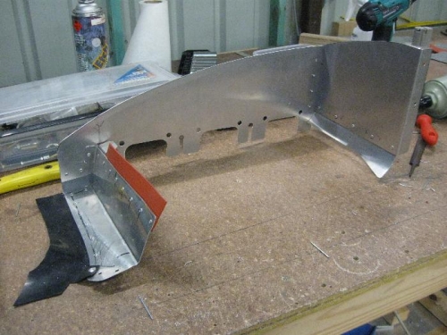

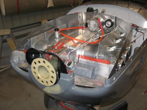

Installed baffle rubber to the front deflectors.
Joined the side plates, front and rear deflectors together as one piece.
Final trimmed the top edges ready for the rubber.
When accessing the heads, both sides of the fence come off as one piece as shown here
