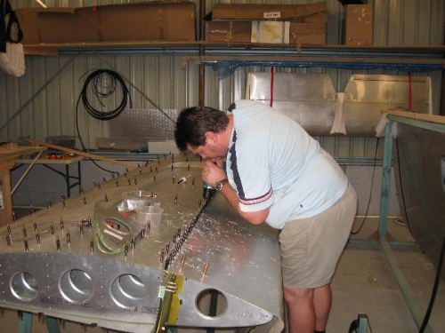

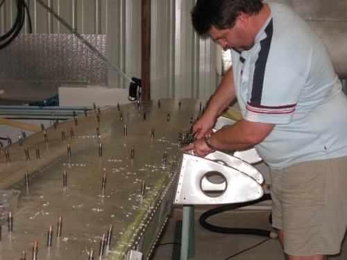

Reinstalled top skins and backdrilled into the new spar extrusion. Also added the extra rivets to the spar line as per plans.
Trued up the wing with my SMARTOOL inclinometer to bang on ZERO all over and clecoed everything up.
Drilling an extra rivet between the existing rivets as detailed on the plans
