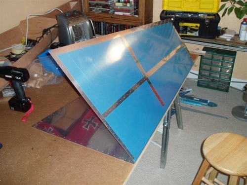

Step 44: I did everything but the skins when I was working last time, so today I took off the protective plastic on the insides of all the skins. Using a ruler and a hot soldering iron I removed strips of the plastic on the outside, so I could get to the rivet lines for deburring and dimpling.All holes were deburred (inside and out), just waiting for my DRDT-2 to perform the dimpling.
Deburred and ready for dimpling
