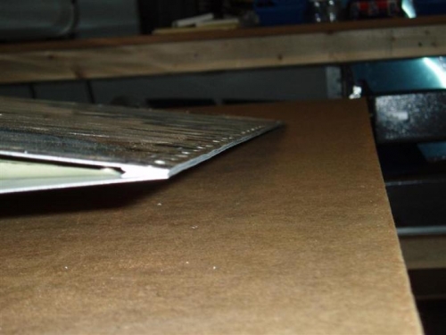

Rudder Step 40 - 42: Finished trailing edge
Steps 40 - 42. Finished the trailing edge today by completely setting the rivets using a normal mushroom rivet set with the back riveting plate. Came out fine, with just a touch of bow towards the bottom but hardly noticable.
