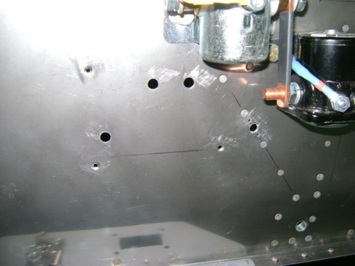

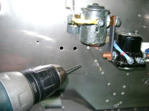

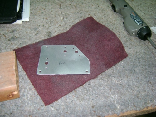

I drilled the firewall for the nutplate that will mount on the firewall stiffener. I used an old nutplate as a drill guide. Deburred holes and dimpled the firewall for the doubler rivets and countersunk the firewall for the nutplate rivets. Scuffed the doubler to prepare for priming.
