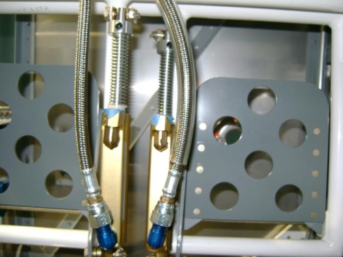

Brief Description:  Install Brake Springs
While I still have the forward fuselage skin off I'm doing as much as I can in this area. Have read about dragging brake problems and Ken had one on his RV-7, so I decided to add the helper springs now, to hopefully head off any problems. Researched the procedure on VAF and found a parts list, got the parts from McMaster Carr, and installation was straightforward with the easy access I have right now.
One done
One done
Right side done

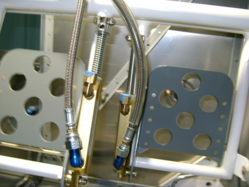

Right side done
Left side done
Left side done
