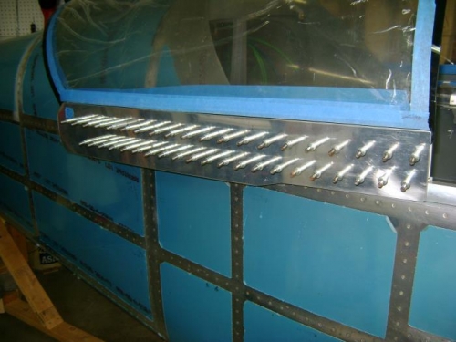

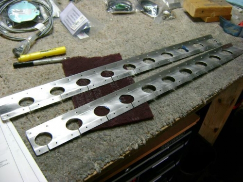

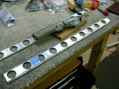

Pulled all the clecos out to remove the skirt braces. Deburred all the holes on the braces and the canopy frame. Scuffed the braces with scotchbrite. Pulled the side skirts and cut the corners on the band saw and cleaned up with scotchbrite wheel. Deburred holes.
Skirt brace cleco'd on
Deburr holes
Deburr holes
Scuff with scotchbrite
