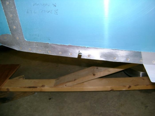

Brief Description:  Cut Flap Actuator Opening
I had previously drilled a 1/2 inch hole in the bottom of the fuselage for the flap actuator pushrod. This hole has to be connected to a hole in the side of the fuselage. Drilled a hole in the pre-cut location for the actuator and used the dremel to connect the two holes. Repeated on the left side. Will enlarge these holes after wings are installed.
Cutting opening for flap actuator
