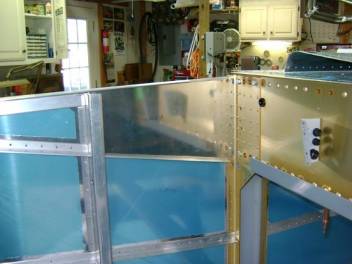

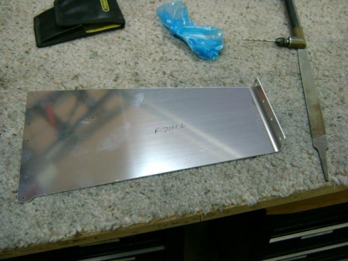

Edge finished the right F-7101 gear attach web with files and scotchbrite. Checked fit to fuselage and rounded edges to fit into longerons. Clamped and cleco'd in place and match drilled to F-713 and F-704. Used angle drill to drill F-7101 to F-902 bulkhead.
Did same process for left side F-7101.
Match drilled both F-902s to the skin.
Fit right F-7101
Fit right F-7101
Prep left F-7101
Prep left F-7101
