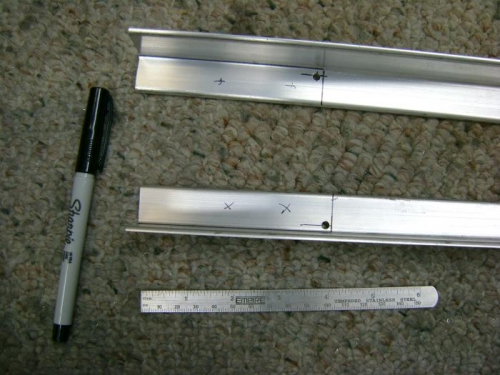

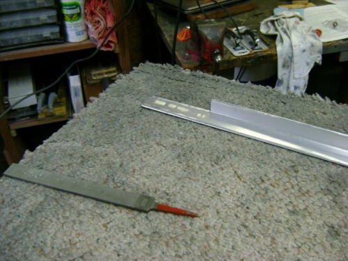

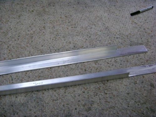

Made the F-717 lower longerons. Cut stock angle to length on the band saw. Marked layout for left and right longerons. Drilled for radius and cut out section on bandsaw. Used files and sander to smooth the cuts. Finished on the scotchbrite wheel.
Mark and drill
Cut and file
Finish
