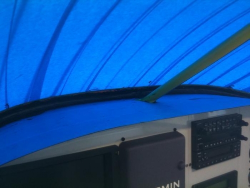

It looks messy now, but wait until all the tape is removed

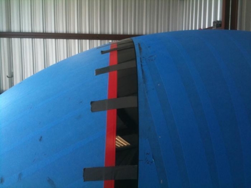

The base fillet
The base fillet

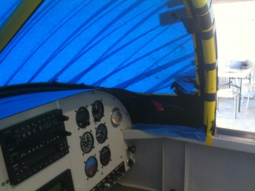

I used duct tape to hold the canopy to the frame while drying
