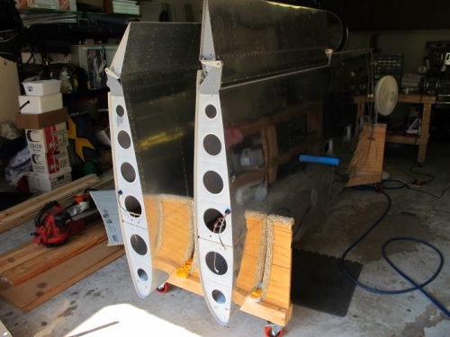

Brief Description:  Finished Riveting Bottom Skins

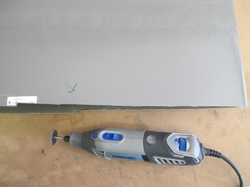

I finally finished [denting] the bottom wing skins. I'm glad this is a low wing plane. Not trying to build an award winner, but a paint job is definitely in its future. I started working on the wingtips, but I read a few build logs that suggested waiting until the wings are on and fully rigged before mounting the tips. This ensures that the tips match the ailerons. It seems that although the brace holds the aileron in the neutral position, some builders have found after rigging that the tips were not aligned and had to cut the trailing edge, adjust and reglass to make them match. I think I will just wait. I still need to finish the empennage tips, so I have something to do until the fuselage kit arrives.
Bottom Skins Riveted
Trimming Wingtips
Trimming Wingtips
