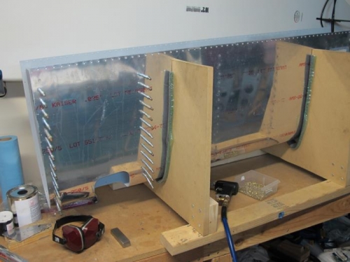

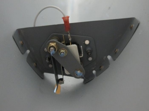

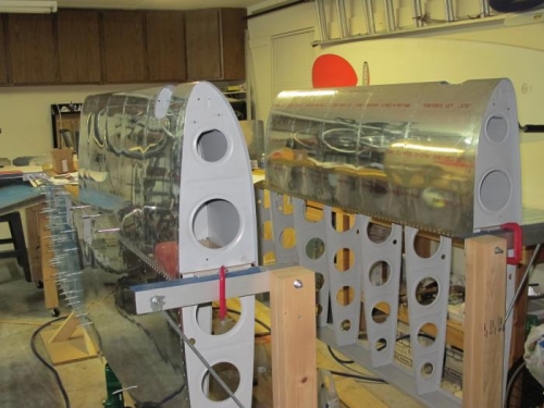

I began the day priming the parts that I didn't get painted the day before due to rain. Just as I was finishing it began to sprinkle so I moved them into the garage. I then made the mistake of opening the garage door which poured water down upon my freshly painted parts. I removed the stall warning assembly from its riblet and riveted the riblet into the leading edge and then reinstalled the assembly. I riveted the ribs into the leading edge using the squeezer and my new bucking bar (this one has an angle cut into one end-very handy!). I used MSP-42, MSP-43 and MSP-44 Cherrymax rivets to attach the leading edge to the spar. The pneumatic squeezer made quick work of the edge rivets. Next up was the Duckworks lens. I got Ginger to help me install the bracket in the leading edge as her hands fit better through the lens opening. I used a 5/32" Plasti Drill from Avery Tools to drill the lens. I chucked it in my corded Dewalt reversible variable speed drill and drilled them in reverse.It worked like a charm. I need to get my lights so I can finish them off. I ended the evening by dimpling and countersinking the access plate openings in the bottom skins, scarfing the overlap, and dimpling some of the rest of the skin holes.
Stall Warning Assembly
Riveting Left Leading Edge
Leading Edges Riveted to Wings
