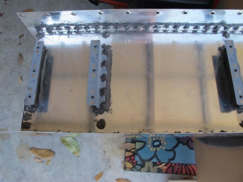

Date:  3-10-2013
Number of Hours:  8.75
Brief Description:  Left Tank Rear Baffle
I installed the rear baffle in the left fuel tank, formed the fillets and encapsulated the rivet heads. I also installed and sealed the access plate. As on the right tank, I used the cork gasket and coated everything in proseal. I will probably bring the tanks inside the house where the temperature is constant to check them for leaks in a week or so. I am glad to be done with sealant for awhile.
Left Rear Baffle
Left Rear Baffle
