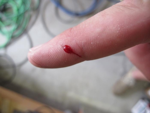

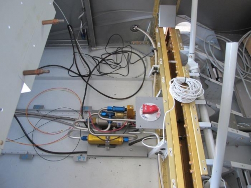

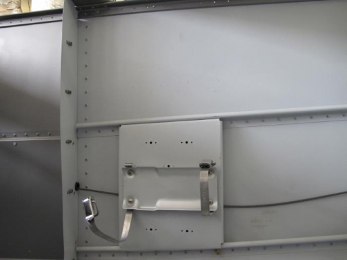

I got back to my build today. The ELT mount that I purchased from Van's years ago did not have platenuts in the correct position to mount the ACK E-04 ELT tray. Unfortunately, I had previously riveted the mounting bracket into the fuse. I drilled out the pulled rivets, removed the mounting bracket, installed platenuts in the proper locations, and attached the new tray to the bracket. I then tried to reattach the bracket but (even more) unfortunately, when I drilled out the lower rivets, I enlarged one of the holes. I ended up using an AN3 bolt in place of a pulled rivet there. I sliced my finger on the unfinished edge of the mounting strap hinge. I strapped the ELT into place and begain pulling the wiring through the fuse. I called it quits early as today is Pete's birthday and so the four of us went out to dinner. Tommorow night, Pete and I will continue to run some wiring.
Mounting the ACK E-04 ELT
ACK Doesn't Believe in Edge Finishing Hinges
Running Wires
Running Wires
