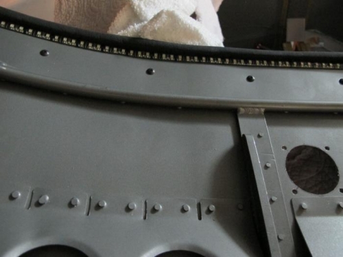

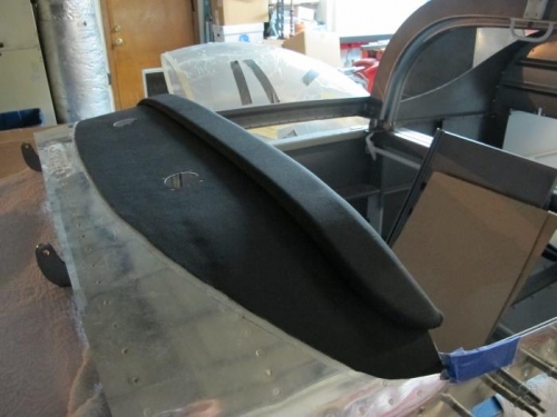

Pete stopped by tonight. I haven't had a chance to get the fasteners to attach the defrost fans but we decided to go ahead and glue the glareshield cover material to the aluminum. We used NAPA aerosol spray glue. Pete taped off the aluminum and I sprayed the aluminum and material with the glue. We carefully placed the material and then smoothed it by hand and with a foam roller. After it was firmly attached, we used an Xacto knife to trim the material from the fan and screw holes. We mounted the edge trim and then attached the LED light strip behind the trim. Kecia notarized my FAA form for me and tomorrow I will mail the check and forms to register the plane with the FAA. I finalized the engraving of my panel with Danny at Stein yesterday. The panel is currently out to be hydrodipped and they expect to have it back and get it engraved next week.

Glareshield Material & Edge Trim Mounted
LED Lights Mounted Behind Glareshield Edge
