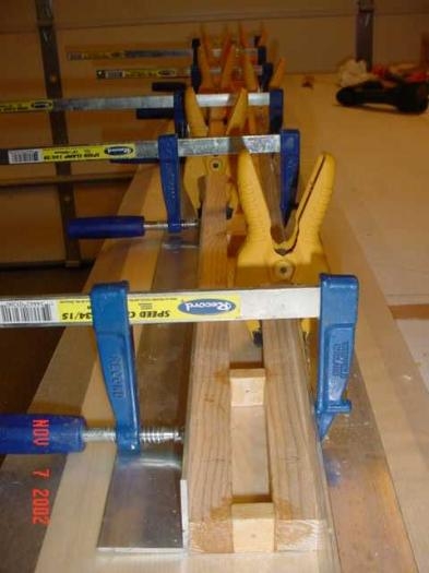

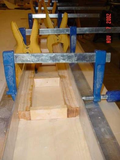

Number of Hours:  6.00
Manual Reference:  Pg 21
Brief Description:  Wing Aft Spar Construction
Cut and fit the vertical pieces for the wing aft spars. Left the spar caps 1/16" (15/16" vs 7/8") thicker than plans called for since the wood was cut to that dimension in the wood kit purchased. Finalized layout of aft spar. Planed a 2" 2x10x8 to try and get a flat surface than the table top. Epoxied vertical pieces on first wing's aft spar. Used the 2" AL angle to keep spar caps straight. Used the planed 10" 2x10 to get a flat surface. Cut and fit the vertical pieces for the second wing aft spar. Epoxied in place and clamped spar caps for the second wing aft spar.
