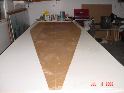

Laid out and cut out full scale of boat (fuselage) bottom. Used brown wrapping paper. Set up guide blocks on table to form (bend) fuselage sides. Widened the seating area 4" from what was called for in plans and widened the firewall two additional inches.
Fuselage Bottom Layout Drawing
