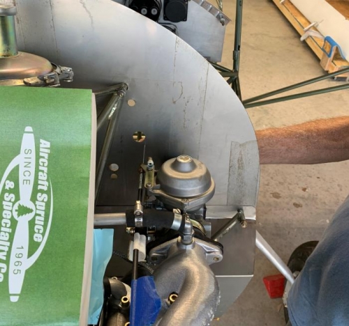

Brief Description:  Firewall throttle cable punctures
After mounting the engine, be realized that the holes that the previous builder drilled for the throttle cable pass throughs were in the wrong location. We got one redrilled this week and will work on the other next week. The port side one will require a doubler since it is pretty close to where the original cable came through.

locating hole for throttle cable on port side
